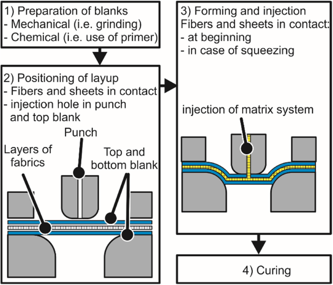

Deep Drawing of Hybrid Fiber–Metal Laminate Composites
The automotive industry started to use metal–polymer–metal products for body-in-white components in the 1980s to decrease the total weight, driven by the increasing oil prices and their beneficial specific strength to weight properties [13]. The production of complex-shaped lightweight components from composites was impeded by missing manufacturing processes. Mennecart et al. [14] analyzed different strategies to form fiber–metal laminates by deep drawing and resin transfer molding (RTM), and deep drawing combined with wet pressing. The benefit of deep drawing and RTM is that the thermoplastic resin injection can be started at an arbitrary drawing depth. Therefore, Mennecart et al. [15] investigated the formability of metal–fiber–metal composites in deep drawing combined with RTM in one step, namely in situ hybridization, as shown in Fig. 5.
Fig. 5
[size=1.6]
Process steps of the in situ hybridization process [15]
[size=1.4]Full size image
The thermoplastic resin is transferred through the deep drawing tool into the composite, infusing the fibers. The inlaying fibers have a significant effect on the formability of the metal blanks and therefore on the whole composite. The fibers deform the metal surface locally due to high contact forces, therefore reducing the overall formability. Therefore, metal alloys with high yield stresses are beneficial for the forming operation of those composites.

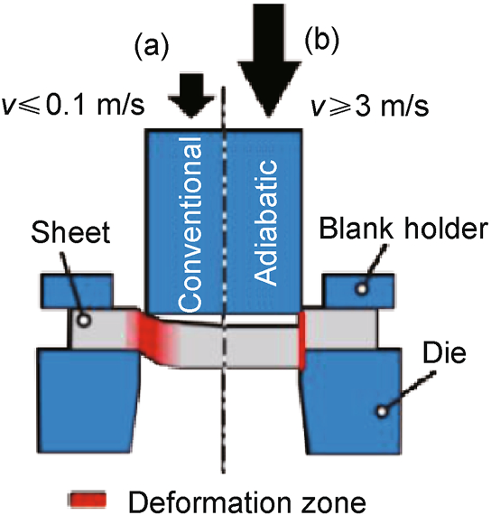

Adiabatic Blanking
Weight reduction in automotive industry can be achieved by the use of advanced high-strength steels (AHSS). These materials demand appropriate cutting processes. Adiabatic blanking is a suitable process to process AHSS parts with excellent cutting surface quality that does not require reworking [21]. Press-hardened parts, with their extreme high strengths and surface hardnesses, are another field of application for adiabatic blanking. The characteristics of the process are high increase in temperature in a very short time in a locally limited volume of material. High local strain rates (<span class="MathJax" id="MathJax-Element-1-Frame" tabindex="0" data-mathml="&#x03B5;&#x02D9;" role="presentation" style="box-sizing: inherit; display: inline; line-height: normal; word-spacing: normal; overflow-wrap: normal; white-space: nowrap; float: none; direction: ltr; max-width: none; max-height: none; min-width: 0px; min-height: 0px; border: 0px; position: relative;">ε˙ε˙&#8201;≥&#8201;103 s&#8722;1) and short process times (t&#8201;<&#8201;2 ms) of adiabatic blanking lead to temperature-induced softening of the material in the blanking area only. The punch travels at velocities v<span class="MathJax" id="MathJax-Element-2-Frame" tabindex="0" data-mathml="&#x2265;" role="presentation" style="box-sizing: inherit; display: inline; line-height: normal; word-spacing: normal; overflow-wrap: normal; white-space: nowrap; float: none; direction: ltr; max-width: none; max-height: none; min-width: 0px; min-height: 0px; border: 0px; position: relative;">≥≥&#8201;3 m/s. Additionally, there is only a limited deformation of the parts, as shown in Fig. 9. As a result, the process route in comparison with the conventional blanking methods for AHSS can be reduced combined with a high cutting quality. Adiabatic shear bands (ASB) are formed during the process as a result of the high local strain rates and temperatures. Special technological properties can be achieved by the sheared surface. This includes the geometry and the mechanical properties of the shear surface.
Fig. 9
[size=1.6]
Process principle: a conventional blanking process; b adiabatic blanking process
The adiabatic cut surface is a right-angled cutting surface that is nearly free of burrs with a fine-textured surface of fracture zone. Efficient simulation strategies and a deep process understanding are required to establish this technology in the industry as a process to cut sheet metal materials. An analytical model considering the thermomechanical material behavior is presented [22] based on material characterization of AHSS with a special focus on the strain rate and temperature-dependent material behavior. The analytical model is able to determine the local temperature increase in shear bands for high deformation rates. These data can be used to predict the final geometry of the sheared surface.

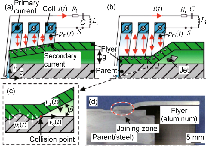

Magnetic Pulse Welding
Dissimilar materials, such as hybrid driveshafts, can meet the mechanical requirements with the benefit of reduced weight. The joining of dissimilar metallic tubes to a hybrid component is challenging for conventional fusion welding processes. Therefore, magnetic pulse welding (MPW) can be utilized to join such components since it is based on the high-velocity collision between the joining partners without an additional heat source [26]. The MPW process and the flyer acceleration due to an electric discharge are shown in Fig. 13, in which C is the capacitor; Ri is the resistor. The process allows a material-bonded joint, and the process principles are as follows: A capacitor bank provides electrical energy that can be discharged within several microseconds and induces a secondary current through the magnetic field in the electroconductive flyer. The flyer is accelerated in radial direction by the Lorentz forces that act between the coil and the flyer. The flyer collides with the fixed inner part at a high velocity and creates a high pressure at the joining partners interface. As a result, a so-called jet is formed which consists of surface particles of both joining partners [26], accompanied by a characteristic light emission to monitor and control the MPW process [27].
Fig. 13
[size=1.6]
MPW process by electromagnetic compression: a Electromagnetic acceleration of the flyer; b collision between flyer and parent; c processes at the collision zone; d example of an aluminum–steel joint [26]
Utilizing the MPW process, Lueg-Althoff et al. [26] presented successful experimental research to join dissimilar metallic tubes (aluminum flyers to steel parents, aluminum flyers to copper parents) with reduced wall thicknesses. A possible application is the production of driveshafts that consist of different materials [28]. With this approach, a bi-metallic stub shaft was produced to an aluminum–steel drive shaft, as shown in Fig. 14.

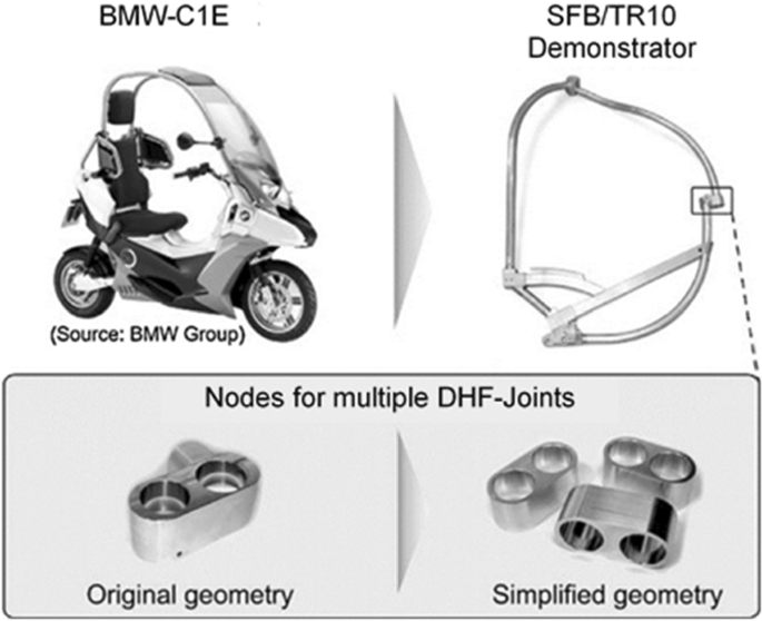

For the manufacturing of lightweight structures, DHF is a great alternative to thermal-based joining processes.
Next to the production of driveshafts, another application is the production of lightweight framework structures. Marré et al. [31] investigated the connection of several tubular parts by a node to create an assembly inspired by the lightweight frame structure for the BMW C1E motorcycle, as shown in Fig. 16.
Fig. 16
[size=1.6]
Lightweight frame structure inspired by the BMW C1E motorcycle [31]

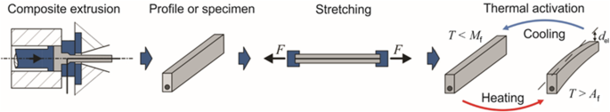

Shape Memory Alloy Metal Matrix Composites
Shape memory metal matrix composites are a novel approach to producing components on the level of system lightweight design. Dahnke et al. [47] presented a new actuator concept based on integrated nickel–titanium (NiTi) wires within an aluminum matrix, which is produced in a continuous composite extrusion process, as shown in Fig. 23, in which Mf is the martensite start temperature; Af is the austenite start temperature. An eccentric positioning of the NiTi wires and an induced prestraining cause a bending moment in the composite when the temperature is increased to a critical value. As a result, an elastic or elastic–plastic deformation of the profile can be triggered, and therefore, such profiles have the ability for a repeatable change of shape which can be controlled by the ambient temperature.
Fig. 23
[size=1.6]
Process chain for the manufacturing of bending actuators by means of composite extrusion [47]
